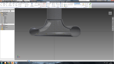

I tried a model with only around 400,000 elements but it didn't really give me the results I wanted. I'm trying to analyse the jet wake profile between the impeller blades, and therefore I used a 0.5 refined mesh on the blade suction surfaces and leading edges, used a uniform mesh in theses regions and then spread the changes. I also used a uniform mesh on the inlet and outlet of the RR. This resulted in around 4 million elements.
On the first model - 400,000 - the secondary flows were not captured. Also, the impeller didnt seem to push the fluid around the volute as expected. I tried to checked why this was with the trace function and found that the traces didnt go through the RR at all; stoping at the end of the inlet or if added at the outlet stoping at the RR. Is this usual?
I have removed both jobs now so unfortunately cannt provide the support files but this is good to know.
Below is a pic of the simple assembly so you have an idea what i am testing. I have also provided a cut plane for reference of the internal geometry. I have tried to make it as cfd ready as possible - no small fillets, unecessary edges etc. The fluid is compressible
Cheers John

I can't do this as our machines are different and mine might not need to use a page file. You can check it on yours though - take a look in the task manager while it's meshing/running and at the bottom you should see whether the page file useage jumps up. This is all I can think of at the moment,.
I have taken a look at the model though and definitely have some suggestions.
Your mesh is incredibly fine, you could mesh this coarser for sure. Perhaps a manual mesh with a finer mesh just on the leading/trailing edges might be more sensible.
Pop the surfaces into groups to help with quick selection. These surfaces can then be given a finer mesh than the Rotating Region.
My manual mesh looks like this, 1.8m elements and should be a good starting point. You could run a mesh sensitivity study from here.
