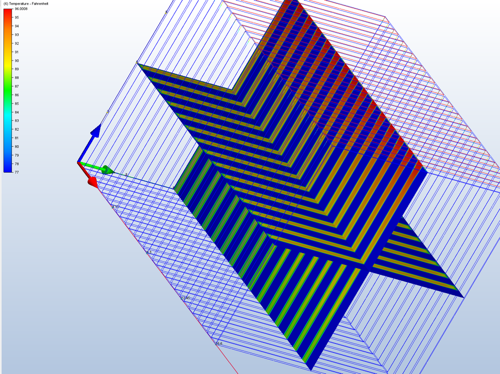

I have defined the temperature and volumetric flow rate boundary conditions to the inlets but unfortunately there is no temperature difference along the channels. Please see the attached file.
Thank you
Message 8 of 14
marwan_azzam
Not sure why you say there is no temperature gradient.
I ran the model as-is and got a temperature gradient as seen in image below.

modess.seyednezhad
Marwan ,
I believe on my computer the software has some technical issues!!
It is so weird to me.
