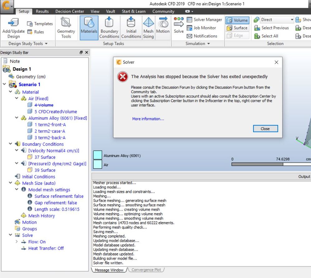

Message 8 of 10
I’ve removed the air box from the model and added the external volume but still the same error.
My system is windows 10 (latest), Autodesk CDF 2019 (Free trial), version 19.0 (I downloaded it some days ago).
Files saved on local SSD. No VPN
I see no way to update the software.
My interface looks different then you have.
In the material list I see “4 Volume”, but I don’t see it in the 3D view. Setting it to air or suppressing it does not help the solver.
the new .cfz file is here
http://wikisend.com/download/463940/CFD_no_air.cfz

Roelof.Feijen
The interference check was done in Autodesk Inventor. You could also do this in Fusion 360.
The second cfz file you uploaded solves without any problems.
From the screenshot it looks like a solver problem or something. The model does mesh.
I would look into these two articles:
https://knowledge.autodesk.com/support/cfd/troubleshooting/caas/sfdcarticles/sfdcarticles/CFD-Solver...

Message 10 of 10
Apparently the biggest problem was my firewall....
I have everything installed and running loacally on my PC but still I had to open port 5041 to allow the solver to run.
The updates of the program to 19.1 where found inside the Autodesk Desktop App
