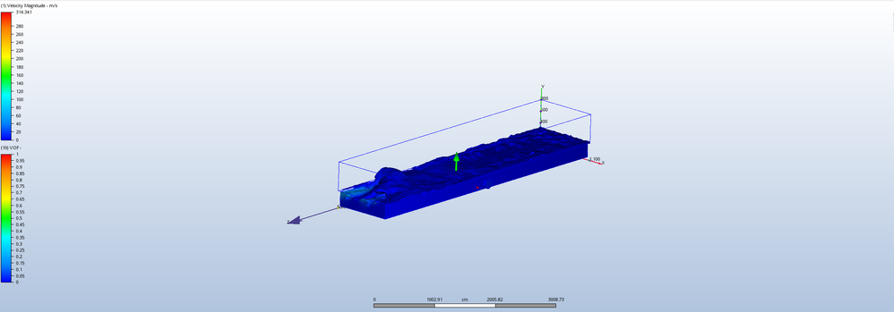

Hello everyone,
Trying to simulate the flow of a river, I come across a phenomenon of a large returning wave from where the water is supposed to be flowing out. Please see pictures below. I wonder what can be the reason for this? Some more detail on the simulation;
Water flows in the river at ~2m/s
From the side a pipeline brings another water line in at ~6m/s
Water leaves at outlet (p=0)
Time step 0,04s (i measured the time it would take the water to go through the smallest mesh i manually measured)

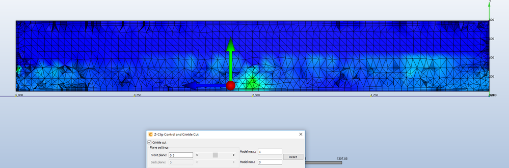

I refined the mesh over the surface of water through adding a region. Although not sure if I succeeded (mesh picture attached)
I did do simulations with finer mesh, smaller time steps (0,01s), but still encountered the same problem.
Although I still think it may have something to do with mesh size, I still wanted to make sure by asking here. May I be missing something else? Any help/suggestion is appreciated!
mesh crinkle cutmesh crinkle cutmeshmesh
3s3s6s6s7,5s7,5s9s9s10,5s10,5s
