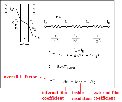

Film coefficients can only be used on the external surfaces of a model - usually to simulate heat lost from a solid to the air. You could also model the air and then you would not need a film coefficient - they are useful to speed things up if you choose not to model/mesh the air though.
If they are applied on an inside wall, the wall must be suppressed from the mesh. This means that once the mesh is created, the film coefficient is actually on the outermost/external surface again.
Does that make sense?

I think you would be confusing many things within CFD. How would this then include both conduction and convection? I suspect that it would not be able to work between both.
These should only be used on the external surfaces, to mimic both conduction and convection. Internally they will cause issues.

In the heat transfer calculation, setting internal film coefficient, external film coefficient and inside insulation are required (shown in the following figure), so we can know the overall heat transfer U-factor.
If we do not set the internal film coefficient, how can we get the internal film coefficient? Will the convection part be calculated by fluid (air) itself or some other way (solid)? After heat transfer calculation, we clicked the internal surface of the window, I do find the internal film coefficient, how we get this number? Does Autodesk CFD help documents have any description or equation to show this? How can we get this coefficient?
Thank you!
