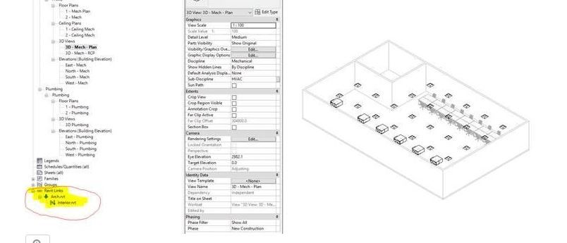

@martyn.messerli About the federated model
Here is a example for demo with my issue, hope it useful for you
When link Interior to Arch, we can see Interior
When link Interior + Arch to MEP
We only see MEP and Arch, and Interior is not visible
@BIM360-ICE, to my knowledge these nested link should be supported so long as `Arch.rvt` has a link to `Interior.rvt` with an `Attach` link type. Could you verify that please?
Best,
Markus
Best,
Markus
Thanks @markus_briglmeir
As you see on image above Interior model link to Arch model with Attachment type.
