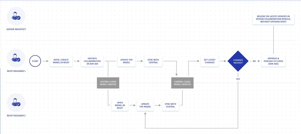

You can see this division in the workflow illustrated below:
The two designers work on the same model. Their individual work is saved on the local copy. When one of them syncs with central, the central cloud model is updated and the changes she made will be visible to the other designer. When they reach a stage when the model is ready to be shared with more people on the team (in this example, it needs to be shared with the senior architect for review), they publish the model and it now shows up with the latest changes in Document Management on the BIM 360 site.
