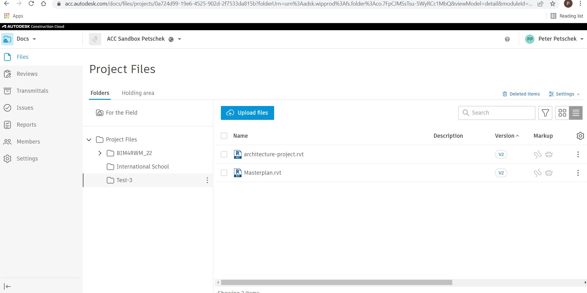

I am using Revit 2022.
I have a Revit masterplan with Civil 3D terrain and a second Revit file with the architecture.
Linking both locally is not problem.
We switched from BIM 360 to ACC
In BIM 360 you had the option to UPLOAD FILES or UPLOAD LINKED FILES
IN ACC DOCS you only have the option to UPLOAD FILES.
I had a look at a solution via COLLABORATE but this is in my opinion too complicated.
Is there no more easy way, like previously in BIM 360?

Three screenshots are included to visualize my problem.
In a couple of weeks I have 35-40 students, who need to upload their linked Revit models on ACC. Last year with BIM 360 it was no problem. We used the button upload linked files ... .The models will be evaluated on ACC. So the architecture has to be part of the masterplan model.
The student are Revit beginners. To explain the whole topic COLLABORATE to beginners only because they need to upload two linked files on ACC, seems to me a bit too much.
It was much more easy in BIM 360 !!!
If I would have known, we would have not switched to ACC.

So, it seems that in ACC I can not upload the two Revit files, like in BIM 360
I have to use COLLABORATE, etc.
I will experiment with it and if my workflow functions I let you know.
Thanks a lot!
Greetings from Switzerland.
Peter
