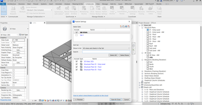

Hello
from my revit collaborate tab, I'm missing Manage could models and publish setting button, any idea why ?
My company has ACC subscription, and I have been using ACC for a while, just noticed this problem in my Revit.

I just reinstalled Revit, and the problem went away...it's strange..

I noticed that this has occured for me today as well with a cloud based model, but instead its the collaborate in cloud button and the manage cloud models button that are missing.  The publish settings button is available though.  I will try the restart of my pc to see if that fixes it, restarting the program did not.  I'm seeing this in Revit 2023.

  Currently the only way to publish an update to cloud models within Revit 2023, that I'm aware of is on the Autodesk Docs page and clicking the 3 dots at the end of the model row.

I think that it is Revit 2023? if yes, you can do the same function from the home interface as following steps:-
from Autodesk Docs
Go to your Right Account and Right Project
If the model is not updated latest , you will find the Publish Latest active
Before you have to check the views and sets you want to publish
