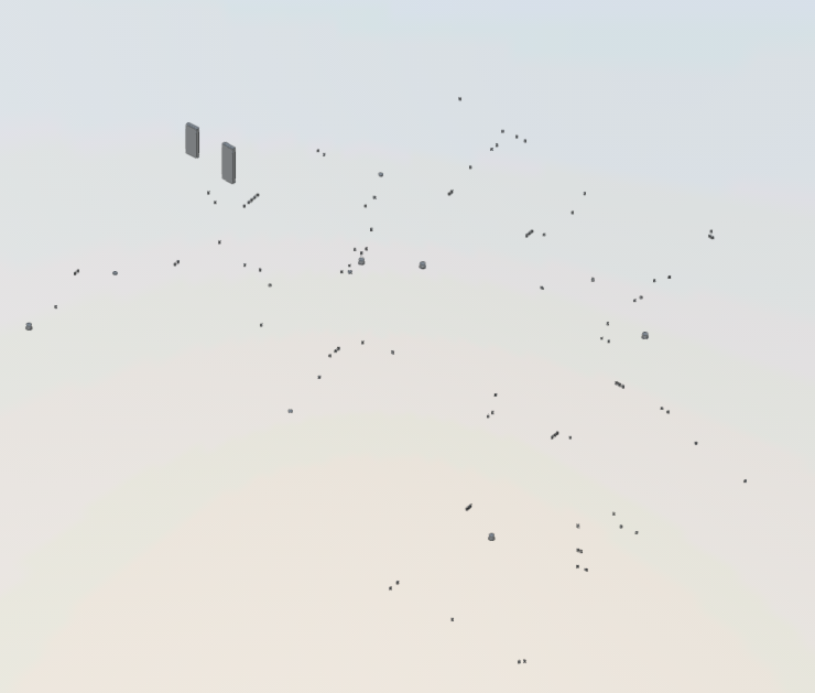

All lights display in my Composite model uploaded to DocsAll lights display in my Composite model uploaded to Docs
What 3D view does 360 Docs use for the 3D view under Project Files? This makes no sense to me. My Revit 3D views show everything. When I upload this Revit file and go to Project files 3D View, none of my lights display. However, I also created a composite Revit model (with linked arch, mech, and stru files) that I uploaded to Docs. That 3D view displays everything. Interesting that everything shows in my Composite model before and after posting to docs. So what's the deal? What does Docs use for the 3D view? Can this not be controlled?Electrical 3D view in 360 DocsElectrical 3D view in 360 DocsElectrical 3D view in RevitElectrical 3D view in Revit

hi @tkeyser5
If you don't set a view to be published, under publish settings then the default 3D view will be used.
If you don't have any 3D views in the model, then it will preview one that looks just like it would if in revit you hit View->3D View->Default 3D View.
If you want a specific view to show in Revit, do the following:
  • Create 3D view
  • Name it for instance "BIM 360 View 1"
  • Adjust the view to the perspective
  • Under Collaborate Panel on the Ribbon select "Publish settings"
  • Make sure a Set AND the desired View both have a check next to the left of their name selected then
  • Hit Save and close
  • Save / Synch Your model
  • Then use manage cloud models to publish the model to BIM 360 (including the newly selected view)
    • Pubish latest
You should see that the desired view is now the one that is being published to BIM 360 docs.

Go into revit and rename the view that is being used as the default view in ACC Build.
Use a name that puts it at the top of the list. I prefer using an "!"
Then in revit set the view up how you want it to appear in ACC Build.
3 hours of my life boiled down to 3 short lines of text. sigh, Revit...

My problem was:
  • I have multiple 3D views in Revit
    • One that shows all elements
    • One that only shows walls <===
    • One that only shows floors
  • For some obscure reason, ACC Docs chooses to show this random view:
Using your workaround, I can change and rename the view that is now used by ACC Docs.
