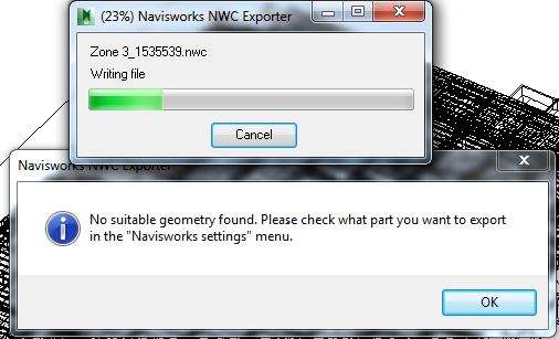

Hi Frederick,
Following your recomendation using revit's addin to export the file in BIM glue 360, im still having problem loading the file
Thanks for the recommendation but we still prefer the NWD. Please advice if the problem in loading the NWD file is resolve.
Thanks and regards.
