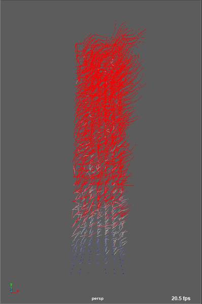

I am trying to achieve an effect where I need to generate fields in a certain way.
Longstory short, field values should increase with height.
But I wanted to use this scalar to tweak individual parameters (magnitude, or frequency, in a turbulent_wind_field).
Can't find a way to connect fields to drive individual parameters so I am using two sets of parameters (YELLOW) and unsing an extra scalar field to blend (GREEN) between these two parameter sets. Which is very limitting.
Considering a node like turbulent_wind_field as example. Is there a way to control individual parameters by an array of floats or vectors, or fields?

@brandaosa Which version of Bifrost are you using? In recent versions we have wind_influence and turbulence_influence which do allow you to modulate the parameters using fields.

OK. Maybe I misunderstood your question. Is turbulent_wind_field your own node? If you want your nodes to be able to work with both float parameters and field parameters, you should leave them as type auto (not set them explicitly to float type). For more advanced uses you need to use e.g. interpret_auto_port_as_scalar which can convert inputs into arrays of floats.
There is a wind field in the grass_wind browser graph example. Perhaps you can use that as inspiration?

You can also retrieve the field from the influence thus:
Hope this helps

So I had a look at what you are trying to do here, and maybe this is a very simple solution.  This one is specifically driving the field by the height of the object, but it can be applied to anything you can make a property out of (so basically everything).
Hope this helps.
