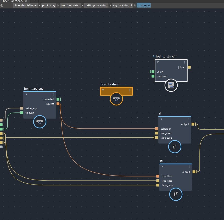

Hi Roland, This pack looks amazing. I'm having trouble getting it to work though. It seems like some of the internal nodes aren't loading properly? I'm not too sure what is going on. I do have the nodes loaded, and am able to create them just fine(the first photo shows a non working float_to_string node, and also a float_to_string node that I was able to create). But the compounds don't seem to load them. I have attached 3 photos to show you what I mean. Do you have any idea what might be happening?
Thanks so much for any help!floatToString2.jpgarray_info_String3.jpgfloatToString.jpg

@CheesymonTony
This is strange.
In the first picture there is one "float_to_string" broken and another one that's ok.
Did you create them manually?
What happens when you create the main nodes (print_static, print_array, etc.)?
Are they all broken (red)?
Which version of Bifrost are you using?
Message 8 of 14
CheesymonTony
Hey Roland, Thanks for getting back to me.
Yes, I created that one manually. I was trying to show that it does exist as node that can be created, but for some reason, is not loading properly in the compound.
All of the main compounds do this. And it seems to be the same situation for all of them, just with varying types of subnodes not loading properly.
I'm working on Bifrost version 2.2.1.2-202106080857-835896f. I will check if there is an update I can do.
Message 9 of 14
CheesymonTony
It looks like it was a version issue. I updated bifrost, and the compounds are now working. Thanks so much, I didn't realize I could update bifrost manually.
