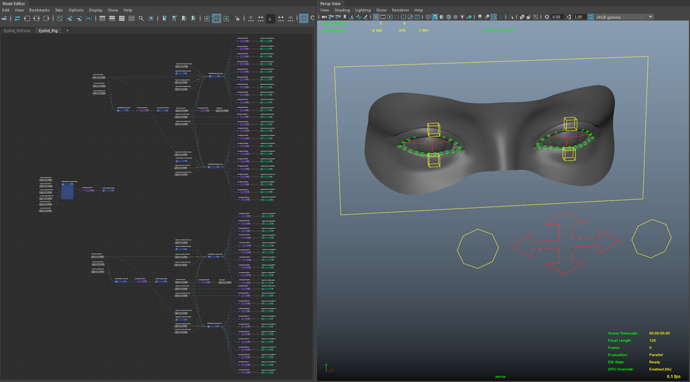

As requested by Christoph in the other forum, I'll post more infos regarding the mjEyelid rigging solver that is included inside the pack, until we have the brand new Compound sharing hub:
rig_setup.pngFeatures:
• variable number of joints for each lid.
• easy to use, meant to automate human eyelid movements.
• fully guide, bone-based; reusable, as long as you follow the original logic.
• tweak closed eye's lid edge shape with an fCurve widget à la SI Face Robot.
• does not depends on any geometry for the initial setup.
• Parallel + GPU override friendly.
Settings:
• elevation_inheritance: global elevation delta weight based on eyeball's local X rotation angle.
• azimuthal_inheritance: global azimuthal delta weight based on eyeball's local Y rotation angle.
• medial_elevation_weight: elevation delta weight of the medial side only.
• lateral_elevation_weight: elevation delta weight of the lateral side only.
• medial_azimuthal_weight: azimuthal delta weight of the medial side only.
• lateral_azimuthal_weight: azimuthal delta weight of the lateral side only.
• num_deformers: the numbers of output joints that you want.
• edge_deformation: the fCurve widget to tweak the closed eyelid's shape.
• use_fCurve: use the edge_deformation fCurve or not.
• is_low_side: toggle if it is the lower eyelid.
• is_right_side: toggle if the right side eyelid.
Current limitations:
• you cannot connect the fCurve into the top level's inputs, nor control it from maya's Attribute Editor UI.
• closing lid controllers while having values near 1.0 on "inheritance" settings doesn't produce realistic results. While having eyes closed, disable or set low values like 0.1 on these.
• lack of DAG controllers for manual adjustments on medial / lateral ctls.
The demo scene will be provided later.

Many thanks Maxime.
I have to dig into that solver again. So much to learn.
