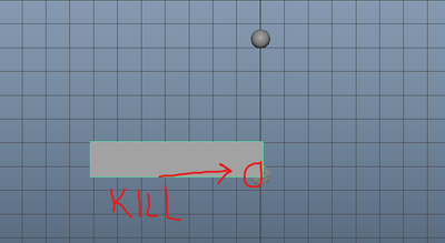

The MPM GEL emitter emits particles. There's geometry underneath. When the particles reach the geometry and intersect it, they should die. How do I do this? I can't find any guides, and the GPT chat doesn't explain how to make nodes either.

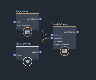

you can use a mask  + a kill influence to do that - where in the mask you cube input will be and make sure you pick Mesh in the geo shape of your mask node

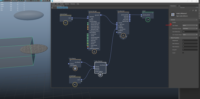

It doesn't work. Did I do everything right?
sepu6
just check absolute on the kill influence
