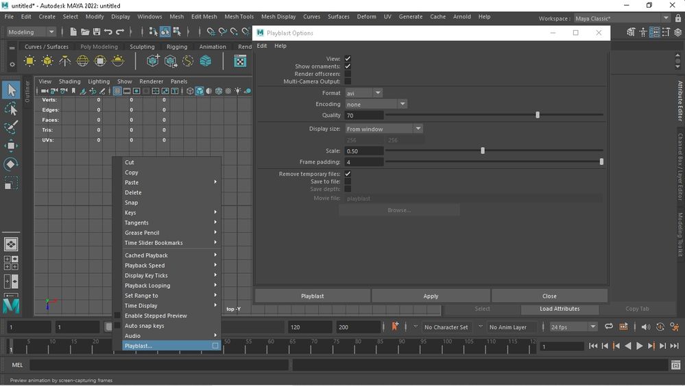

cavescholar
Just curious but how are you starting the render, and are you doing it to evaluate your scene for errors?
Option 1:
Playblast your animation.
This will allow to evaluate the scene for errors before rendering.
a.) Right-click (Control-click Mac) the TIMELINE and open Playblast options window.
b.) Scroll down and check mark SAVE TO FILE, choose where you want to save it.
Right-click TimelineRight-click Timeline
Of course there are so many other options to Playblast, link below.
 Playblast an Animation: link for more information and options.
     (https://help.autodesk.com/view/MAYAUL/2022/ENU/?guid=GUID-1C6EDC8D-DA67-490E-81F1-1205336DEBD9)
