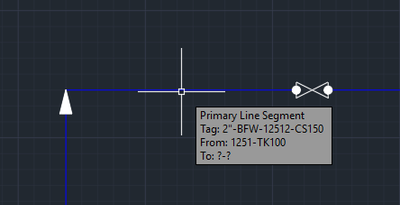

I am creating a master project for my office and I am setting it up a master project. I am testing the validation between the P&ID and 3d. When I do, I get a mismatch validation when I should.
I created the line on the P&ID and used the P&ID line list to place it in the 3D model.
I am no sure why it says it doesn't exist in the P&IDs when that is where I pulled it from.

have you taken a really close look at the validation error message?
P&ID TAG = 2"-BFW-12512-CS150
P3D TAG = BFW-12512
What is missing from the 3D TAG = 2" and CS150.
So, the error has been identified, but not fixed!

The P&ID tag is the pipe line segment tag. The P3D is the pipe line group tag. I will check my mapping settings though to see if I got them mixed up.
Phillip_J_Hall
Well I got it to work the way you showed. I wish the validation process would be better described so I know what it was looking for as far as line segments, line groups, line segment tags, line number tags, and line group tags.
