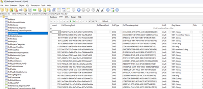

Hi all - this occurs when generating or attempting to check in a generated iso within a BIM 360 project.
Failed to create file in BIM 360 project: xxxxx-P-ISO-005.dwg
JSON API error, Conflict with errors: {409 ERR_CONFLICT The entity id already existed a38ac421-021c-4261-bb16-74279c23de3f }
There is no existing isometric already checked in- therefore we cannot check it out to 'remove' it. It appears to be a stuck entity id. Project Audit-no luck. Has anyone encountered this before? How did you resolve?

I have no experience with the error you mention and besides the links shared by @Radwan-Almsora I can't give you another cause. But if you wish to see if the .dwg still exists and is registered in the database, you'll need the iso.dcf.
The actual drawings are maintained in the PnPDrawings table. Clearing them from that row will effectively remove them from the database. Be aware however that they might still be referenced in the PnPDrawingCustomProperties table. The PnPDrawingGuid column is used to link the two. I don't think there will be an issue if you only remove a dwg from the drawings table, but the view might still throw a hissy fit if it cannot correctly join drawings with their custom properties.
try it out on a backup first.
