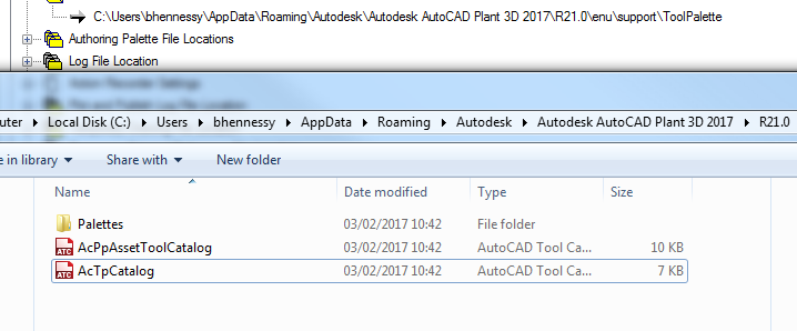

Thanks for reply
Yes , I have that, so how do i add palettes to Toolbar from this?
Nevermind
I added the Palettes to Toolbar by going to Manage>toolpalettes and importing the Palette Group.xpg file.
