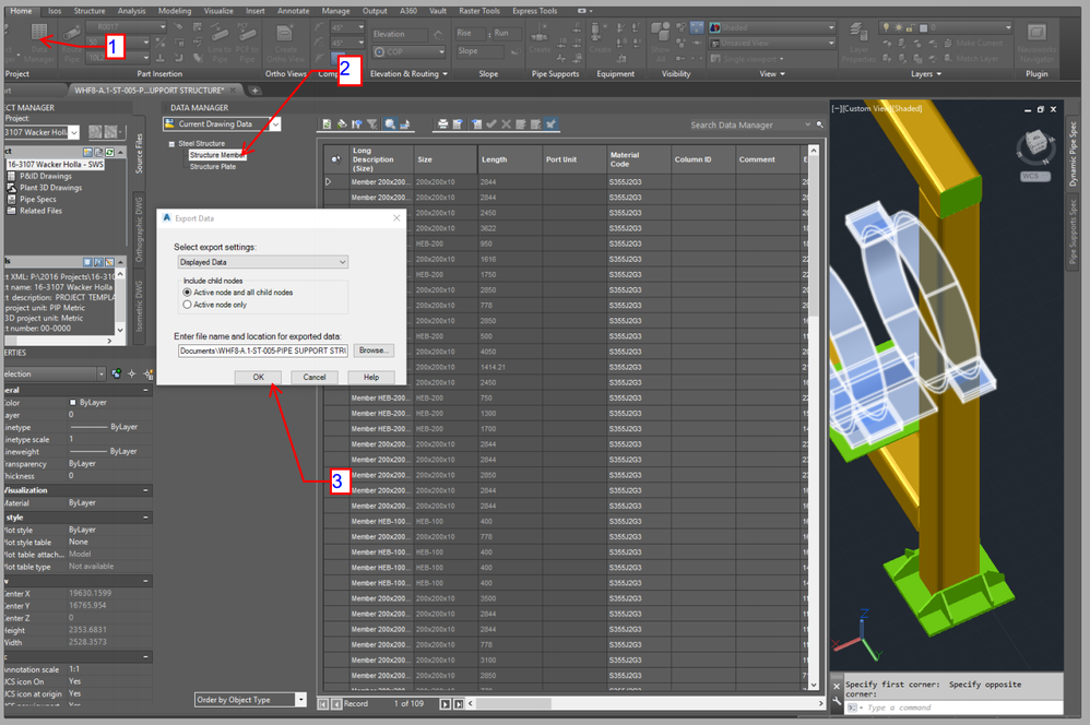

I'm struggling with the same problem. Closing to the end of the project, some data need to be exported to the third party and bellow attached error appears:
I have installed Autocad Plant 2017 with 2017.1 update.  Does someone have similar problem?

cyklosarin
I think the worksteps I made are very typical:
1 - open data manager
2 - right click on object group - > export
3 - OK (I tried all options not only marked on screenshot bellow)
4 - error shows up
My IT manager reinstalled windows and other software so now it is working. But I'm curious why this error appears while I have autocad plant 2017.1 installed. According to the autodesk  community database on this version it should work.
