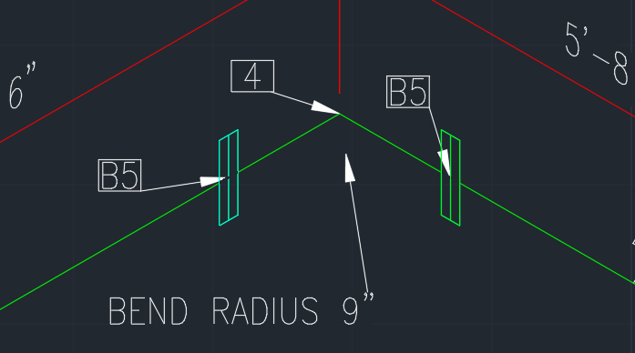

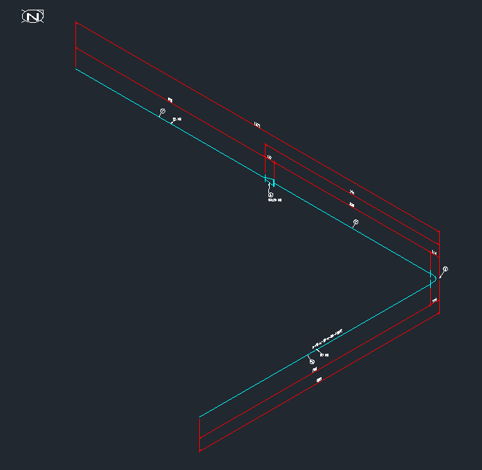

I have created a piping spec using the RESISTOFLEX cat within P3D2016 - it all models well, however when you run the Isos they run ok, but the flanges are drawn on top of each other - see attached. It doesn't seem to make any difference if you change the SKEY, the bit that controls the pipe at each end is the TYPE=PIPE-FIXED portion.
SKEY=FPFL,TYPE=PIPE-FIXED
Has anyone had a similar experience & how can it be overcome?

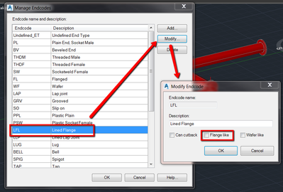

If you use the PLANTENDCODES command and deselect the Flange Like option for the LFL Endcode,
you should get the following result:
Is that the result you need?

No it should be shown as 2 separate flanges as they are 2 separate items spaced apart where a gasket should be ie as per your original Iso but not with the gasket.
Thanks.

One option is to edit the iso symbol so that it looks like two separate flanges.
Am I correct in thinking that you don't need the individual flanges listed in the BOM and that it is just the visual appearance that you need in the iso?

Yes its just the appearance of the ISO line work - the BOM is correct (as per the original ISO 1.png file posted). I get the feeling that this must be a bug - if the Iso pipe spool symbol works correctly when a gasket is asked for & doesn't draw correctly when the gasket isn't required (ie when using lined piping). However if it is a bug, I am surprised that it hasn't been reported before or am I missing something!

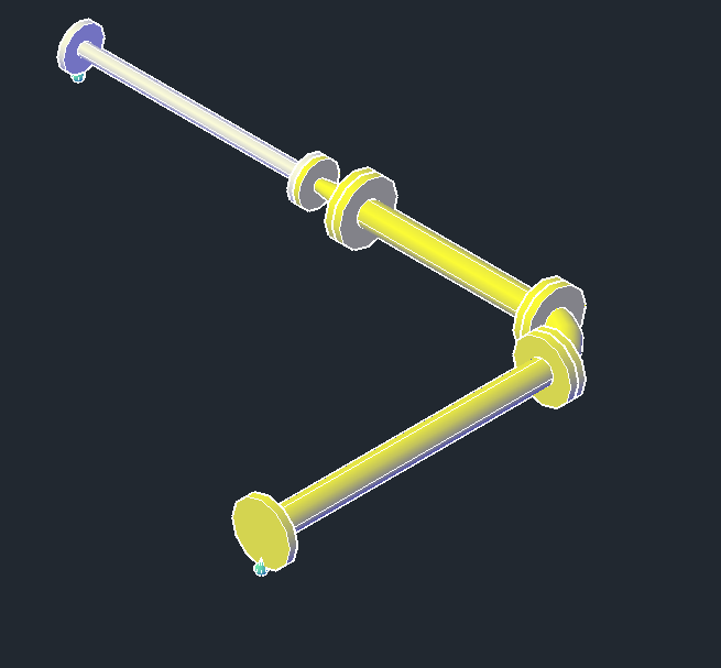

I have the same problem that MOLGRAND is having.  It draws the two flanges as a sing flange rather than two separate flanges.  I've found that the lined pipe module in P3D is barely usable at best.  Way too much clean up and issues like this.

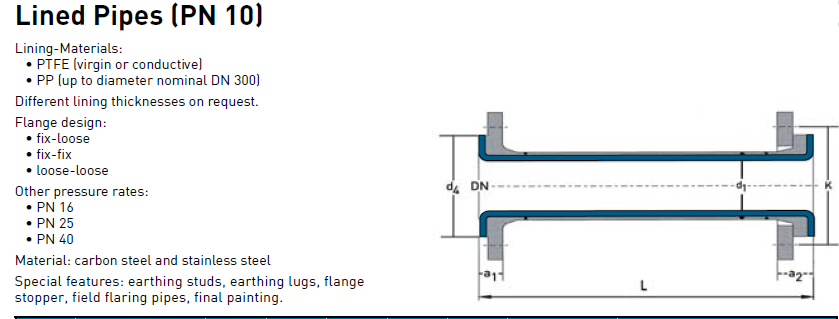

I am also not satidfied with ISO output with lined pipes and fittings.I would expect, that for every piece it is possible to define each end separatelly (also for fixed pipe). Lined pipes have usually one end fixed and one end loose (see attachment), but also all other alternatives are possible. So flange type (fixed or loose) shall be fully represented also on ISO drawing. What I am also missing is DIN part of Resistoflex catalog. For many catalogs there is normally only ANSI available.
