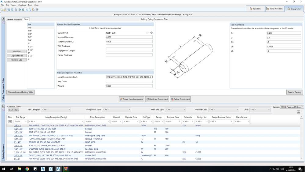

Screenshot_1.jpgMy project is set up in metric but this spec editor is always showing imperial, how to change to metric ?

The Catalog Editor will default to using the units of nominal diameter in which the components were originally created.  So, for example, components in the ASME catalog will default to imperial units since they are defined in inches.
You can, however, override the units from the Catalog menu:
