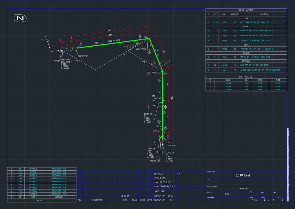

Phantom Pipes on Iso
Dear forum members
Using Autodesk Plant design suite premium 2016
Single person project ( SQLite based database )
I made an nice 3d model with only 1 piece of equipment and 9 pieces of pipe
When I make an iso of 1 of thos pipes I get phantom pipes on it as well
I added 1 dwg and used revcloud to point to the phantom pipes
If you just delete the brown and green line inside the revcloud you see the original dotted line with the pipebreak symbol and there is also text written CONT'D ON.
Does anyone of you know why in the world the iso is showing pipes that not even exist?
I used wblock to transfer all the pipes to an new dwg
When deleting the pipes there will be written OPEN END wich is correct.
As soon as you connect an pipe to it the phantom pipe comes around the corner as well.
Hope to hear from someone
Thanks in advance 🙂

Do those phantom pipes exist in another model (not your main piping model) that is part of the project?
You can use Data Manager to look at "Plant 3D project data" and check for this. When you run an ISO, it looks at all models in a project for parts with that line number. We have had a similar issue with  one of our users having pipe in an equipment model.

As far as i know those pipes do not exist in any other project since this is the very first one for this environment.
No other projects excist and no xrefs are used.
I think I know what the issue is.
In data manager there are a lot of connectors and other stuff that is unassigned.
we did not know this so thanks for pointing out.
I will correct this and see what happens.
As far as it looks now p3d is simply confused because of those unassigned connectors

Here's the steps I would take:
- command plantaudit (in drawing)
- project audit
- project compress
- purge cache
If that fails:
- remove drawing from the project
- repeat steps above (except first)
- copy dwg to project

I did those steps already in different order
The only thing happened is that most of my pipes become unassigned
I had 231 unassigned parts in my model
Yesterday that was lesser and fixed by me just to find out that the part went back to unassigned
I think there is a bigger issue going on

is this isometry correct?
I think the problem lies in the version Plant 3D 2016.
With Plant 3D 2016 I have the same effect as yours.
With Plant 3D 2018 you see the result in the attached isometry.
If my reply was helpful, please give a "Kudo" or click the "Accept as Solution" button below (or both).

In the end I fixed this using the info all of you provided
@darrelldixon you pussed me into the datamanager and many thanks for that
@jabowabo thanks for pointing out the possible purge / repair steps
@h_eger for deeper investigation on my source file
What did I do to solve this
1. open affected project.
2. remove the affected dwg from project
3. clean up the project i.e. purge / compress
4. add an new dwg ( DO NOT COPY DWG TO PROJECT )
5. open the old dwg and CTRL A + CTRL C
6. paste everything in the newly made dwg.
from here it will be tricky
7. go to data manager and look if there are unassigned parts.  ( change order by object type to order by area )
8. reassign any unassigned parts
9. purge / plantaudit / project audit / compress and close P3D and use PnPLocalDataCachePurger.exe
10. check datamanger 1 more time and repeat nr 9 one more time and finally generate Iso
For me this fixed the issue
