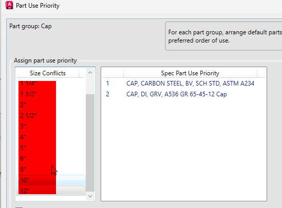

Is there anyway to keep the priority of one part over other another without giving priority of each size?
For example here for caps, I have to give priority by selecting one by one sizes and change the priority. I want to do priority all in once for caps.
Is it possible?

@santoshbaraiya ,
Quick answer: No

A workaround I usually do is:
1. Remove the less prio item from spec.
2. Save the spec
3. Add less prio item again to the spec
And then you will have correct prio without assign priority for each size.
