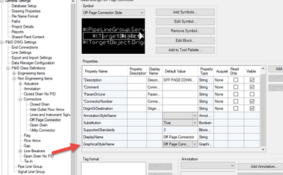

Now I wanted to add a new, simpler symbol to the Off-page connector (OPC) item. I edited a new symbol and it worked fine.
But then I created a new drawing in this project. For some reason, when I add this new OPC symbol in this new drawing the old symbol is inserted! It is so strange because in older drawings the new OPC is inserted and works fine but in this drawing it's always the old one that appears!

From the top of my head, the following information can give us more to go on and see what the issue is?
Did you create a new symbol for the 'out-of-the-box' off-page-connector. Or did you create a new connector type?
Did you set the graphicalstylename of your new symbol to the correct symbol?
Are you using a completely new block definition (with a new name) or are you changing the existing block definition?

I created a new symbol for the out-of-the-box OPC.
I changed the GraphicalStyleName, as you suggested and it worked!
