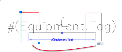

Now instead of the underline being the same length as the Equipment Tag they are all one length. This is for a whole project and no apparent reason. I have tried to go into the project setup and fix this, but no matter what I do it stays the same. The first snip is how it looks now and the second snip is from another project and how it used to look. I have been trying to fix this for over a day and can't figure it out.

In the project configuration, check that the equipment annotation block is correctly configured.
The underscore must be stretched on both sides
The linear parameter must have as its name the name of the property to write, here #(Equipment.Tag)
