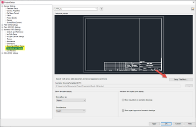

To change the continuation annotation (and others) you can change them in the project setup -> Isometric DWG Settings (per iso style)
To change the dwg name in the titleblock you can do this in several ways. It all depends on how you want to name to be constructed. Is the shown name the same as the file name or is it a more complex nomenclature tied to the pipe line group?
In the first case the best way in my opinion is to modify the title block and add a basic autocad text field:
to modify the title block - go to the project setup -> Isometric DWG Settings -> Title Block and Display -> Setup Title Block...

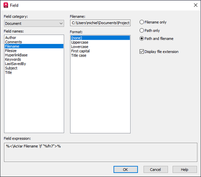

To add a field you can type a text, double click it to edit, and right click for the insert field option. Or you can use the FIELD command directly (you can find it in the Insert tab in the ribbon): Choose the desired field options.
The field will be shown with a gray background in your template. The content will be updated when you open/save/print/regen the drawing and it will always refer to the actual name of the document.
