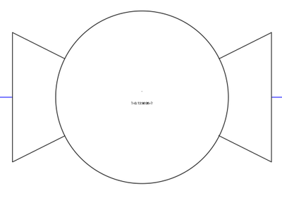

How do I change the tag font size on a symbol in Plant 3d P&ID. This is a Ball Valve. The tag text inside is too small.

mahiparmar26
@andre.enochKKP39
Please follow below steps,
1. Go to project setup
2. Select hand Valves under P&ID Drawing settings- P&ID Class definitions - Inline assets
3. Select annotation style and press Edit Block button
4. Select tag and go to properties by right click on it
5. Change the text height as your choice.
6. close block editor and save the changes.
7. press apply and ok button.
