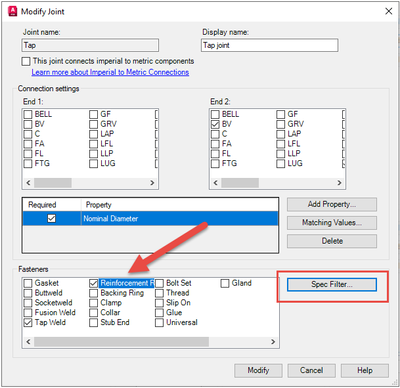

You can add reinforcement rings to your catalog and spec and define default sizes/descriptions, etc.
When available in the spec (you will need to make one for each possible combination of sizes) the ring from the spec with all its properties will be placed instead of the hard-coded one.
You can also edit the joint setup so that rings are placed automatically with each tapweld
Don't forget to place a spec filter to match the nominal diameters (both) otherwise the wrong size ring might be inserted.
