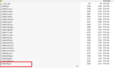

Dear all,
In my customscripts folder, It has many scripsub. So I want to add them to  variants.zip---varmain like  I can import a script from variants.zip
For example:
from varmain.supportsub.csgcsub.csgc001 import  CSGC001.
I tried many ways to add them. In my custom scrip, I make a copy a custom scrip, eg: elbow45.pyc then I insert them to variants.zip\varmain\arcsub\cpbdsub. However, It not working. Someone that success with it please tell for me.

@traiduong014969 is there any specifc resaon to aad the custom script in to the varmain folder?You can import you sub script from other location also.

I recommend not mixing custom files with installed files. It's easier to keep track of your files if they are separated into their own directories.

I agree.  It is best not to mix custom scripts with the out-of-the-box variants scripts.
Keep in mind that you can always call any custom script such as your elbow45 within the current script like so:
At the top of your script after you import packages...
# Import Python Packages
from aqa.math import *
import math
from varmain.primitiv import *
from varmain.var_basic import *
from varmain.custom import *
#Add Custom Python Packages
import os
import sys
sys.path.append(os.path.normpath(sys.PnP3dNativeContentCustomScriptsPath))
from elbow45 import *
