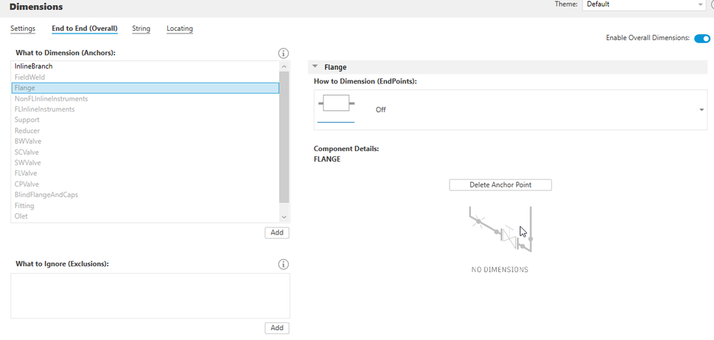

I'm having trouble finding the setting to toggle this dimension for what looks like flange thickness. Does anyone know where this is configured?
I'm using Plant3D 2022

Thanks @rajendra.prajapat but that doesn't seem to be having any affect. I tried the InlineBranch and the Flange option and set both to off without any change.
I will play around with this some more on a default project to rule out any other settings that might have been changed.
