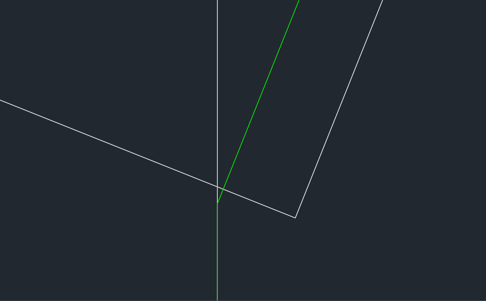

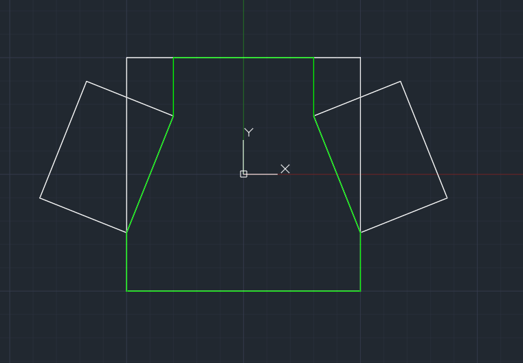

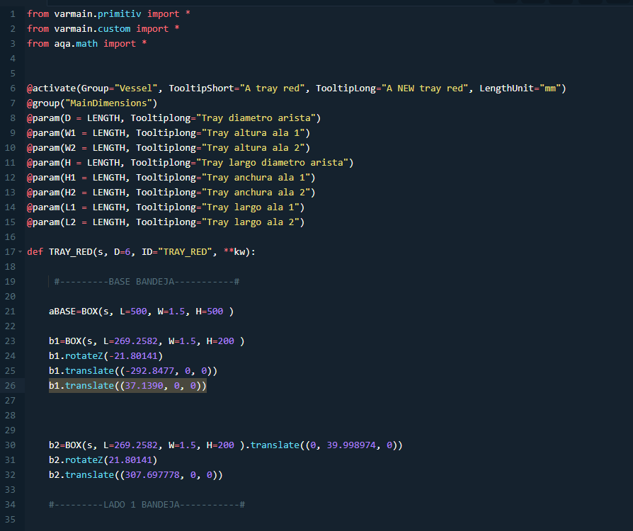

Now i have a different problem, i am trying to create a reduction tray fitting, to do so i´m creating several shapes, then subtracting each other to to create the final result, the thing is when i write the distances to move theses pieces in X and Y i cannot achieve to place them in th exact place where i want to because of the decimals, i measured everything before start doing this, but there is something wrong, here i have the code:
This is what i want:
This is how i am doing the process:
And this is the result (i have overlapped the shape green which is what i want to compare the result):
When i look closely i can see the pieces don´t fit accuratedly:
I have to add several decimals after the comma to get more accuracy but i cannot achieve it
I had to change the order of the code to get accuracy:
I modified the way i moved b1, this way i could change some of the displacement values using less decimals, for example the b1.translate((37.1390, 0, 0)) was the original value, then i had to modify that value and the rest of the values when i set the code like in b2, but appearently changing the order of the code affects the final result.
For example this is how originaly was b1 but i had to change the values because b1 didn´t move to the coordinates written in this codes
Here is the final result:
And you can notice that now fits exactly where it should be:
