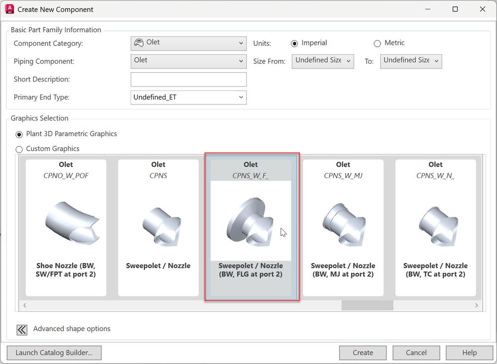

I want to create the above "FLANGE REDUCING SADDLE" components for my RTRP CATALOG.
Please can someone show me in what "COMPONENT CATEGORY" it has to be added and what will be the "Iso Symbol Type" and "Iso Symbol SKEY".
Appreciate your help

"Iso Symbol Type" = OLET
"Iso Symbol SKEY" = FLBW (You still need to create the ISO symbol for this as it does not yet exist.)

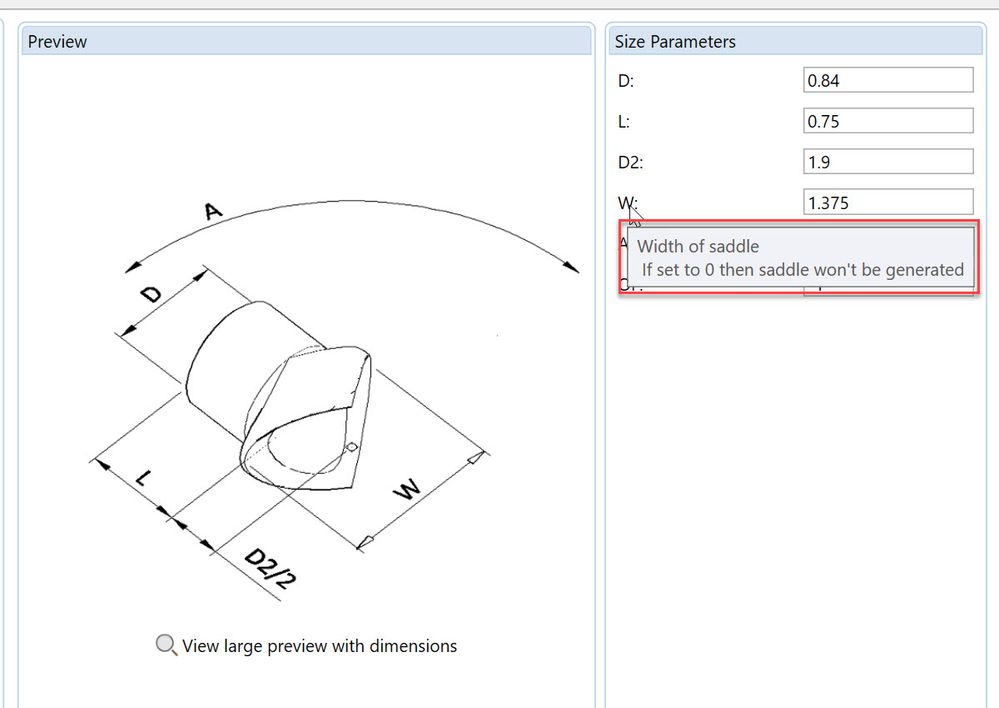

How to show the saddle, as shown in the above catalog.
Regards,
Message 4 of 15
h_eger
Set the value ‘W’ to 0 and it will work.
If my reply was helpful, please give a "Kudo" or click the "Accept as Solution" button below (or both).

nisard
Thank You @h_eger for your prompt reply.
I did as per your instructions, but the saddle is not showing in the 3Dmodel, below is the information I filled while creating the component:
I put 'W' as 152, which is the length of saddle
After linking the above component in the spec , I got the below result, which is not what I need for the specs:
The Olet I need for my specs is as shown below:
It comes with a pipe, flange and saddle, which will be connected as a branch to a pipe with adhesive.
Please show where I am going wrong.

h_eger
Such components are not included in the scope of delivery of the Plant 3D variant design.
You have to construct such a part with Python Script.

In that case I was thinking of creating a custom part. I am stuck with what "COMPONENT CATEGORY" it has to be added and what will be the "Iso Symbol Type" and "Iso Symbol SKEY" for the custom part.

EddyWagner
Part Type:
Olet.
You can base it on an existing template.

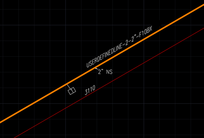

But from what I’ve seen, there’s no OLET with "FL" in the SKEY — it returned a missing symbol. For testing purposes, I used:
"SKEY=WTBW, TYPE=OLET"
And this was the result in the isometric:
If you want something custom, you’ll need to either find an existing symbol that fits better or create a new custom one.

I used the below setting for creating Custom Part - FLANGED REDUCING SADDLE
Please note that the "FLANGED REDUCING SADDLE" IS GLUED TO THE RTRP PIPE
 In my 3D model it looks like this :
PORT 1 = PPL
PORT 2 = FL
Iso Symbol Type = OLET
Iso Symbol SKEY =
In Isometric it should look like below :
Please can you show what setting I should do to get the above Isometric.

You need to configure the SKEY options.
You might try using WTFL. After that, you need to edit the IsoSkeyAcadBlockMap.xml file:
<!-- Begin: Olets -->
<SkeyMap SKEY="SKSW" AcadBlock="Olet1"/>
<SkeyMap SKEY="TH??" AcadBlock="Olet1"/>
<SkeyMap SKEY="WTBW" AcadBlock="Olet1"/>
<SkeyMap SKEY="WTFT" AcadBlock="Olet3"/>
<SkeyMap SKEY="HC??" AcadBlock="Olet-Half Coupling"/>
<SkeyMap SKEY="LA??" AcadBlock="Latrolet1"/>
<SkeyMap SKEY="FE??" AcadBlock="Ferrule-Flared"/>
<!-- End: Olets -->
Then, you need to create the symbol in Edit Isometric Symbols.
You can use Olet1 as a base.
Edit the block as needed and save it as Olet3.
Remember, your SKEY must be WTFT.
