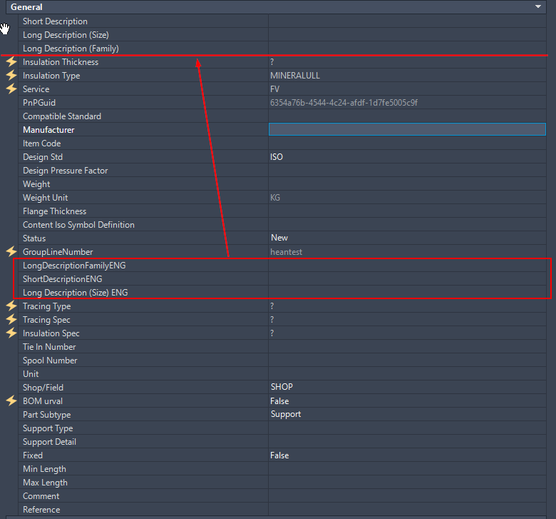

We want to create custom properties in our catalogs in order to use two languages. As you can see in attached image I have created some custom properties for descriptions. Now, what I would like to do is move these up below the original properties. Now it's kind of a mess. I can't order them in Project Setup, is there another way to rearrange the properties window?

To my knowledge it's not possible to rearrange properties. They are placed in the same order as they are in the class definitions.
I was looking into the same a while ago.

Ah, OK! You have to go in there... I will try that, thank you!

Does someone know how to update the order of the properties for a collobaration project? I can modify them in the cache file but when that is refreshed from ACC the order is the old order again.
Is there a way to force the changes to the collobaration project?

I haven't tested this, but I would expect that you will need to check out the project settings before changing the order.
