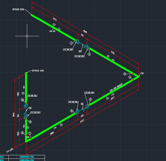

 I have the same problem. I created new symbol. write to acadblockmap.xml, generated iso is good, but orientation Y-Strainer is bad.
Iso: first Y-strainer is by chance good. Other are bad orientation.
Why?
I set up Flip Y, result = zero. FlipY and X, result = zero. Not Flip totaly **** 🙂
No funtion 🙂
Thank you for your supports

HI,
 ISO is bad. You have flip direction strainer.
Message 8 of 18

Ruffy85
Ok i have changed my orientation to yours. I see the same. the Strainer in the Vertical line has the wrong orientation.
That looks like a bug. But what you can do here is. Create a new Symbole with a flipped Port 3 to the left site, save it as YSTRAINER2, add it to the xml file, and use this one for the vertical line + the other one which works not correct
than anythign should be fine.
If my reply was helpful, please give a "Kudo" or click the "Accept as Solution" button below (or both).
Message 13 of 18
I do the same. Step by step and finish is the same.2 ports or 3ports it does not matter. 😞
I will rotated the symbols manually.
Thank you for your time

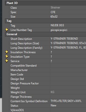

Quite honestly, I'm not sure which of these post above helped. I kept trying things and through trial and error, it worked.
I believe I had the "Type" set incorrectly. I needed "FILTER" in that setting....

 thank you for your reply, but I'm confused.
Which Type is correct?
I have in catalog Miscellaneous/Strainer this is Class and Type=FILTER, Skey=XXFL is not important.
ISO is bad direction. See image up.
Thank you for your reply

This was and is a different problem. As @Ruffy85 pointed out above it would likely be best to create two symbols and see which one works in the orientation you need.
That 'type' is correct - keep in mind the types from catalog editor to IsoSkey are general and not all apply - i probably should have mentioned that caveat but its neither here nor there. When in doubt look at what is already there in a spec or catalog- in the case of strainers they are in the ASME and other catalogs by default.
I believe the type used came from Isogen but i could be wrong. When in doubt and the component is not in Catalog use this:
