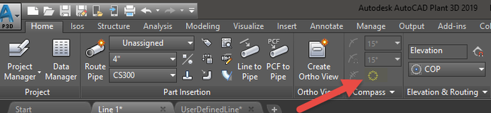

just upgraded to Plant 3D 2019 and i need to turn off the dimension lines and angles that comes with placing pipes.
please see screen shots below.

Hi @tbnorris,
If you're referring to the red angle in your first picture, you can toggle that off by selecting on the Compass button (Home Tab > Compass Panel).
If you'd like to disable dimension lines, you can toggle off the dynamic input. I have attached an article link that will show how to accomplish this below. Hope this helps.
Article link here

tbnorris
Never noticed that switch before.
