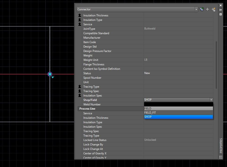

To change the weld status in the model. Select the weld and go to its properties Shop/Field

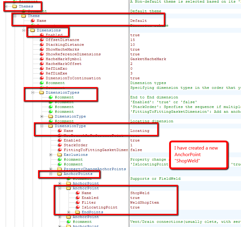

Anchor weldshop.PNG I have done this:

What I have seen from your snapshot, you are in the wrong location. You are in the level DimensionType (name = Overall) but not in DimensionType (name = Locating).
Also, you have to copy for example this:
<AnchorPoint Name="VentDrainConnections" Enabled="true" Filter="OletAndServiceDrAvCvOrRv" IsLocatingPoint="true"><EndPoints><EndPoint EndPointType="Center" /></EndPoints></AnchorPoint>
Paste it now on the same level.
Change then the name. In this example from "VentDrainConnection" to for example "lvsonsbeek" (so the name could be any name but has to be an unique name)
Change the filter, in this example from "OletAndServiceDrAvCvOrRy" to "WeldShopItem"
Save the file

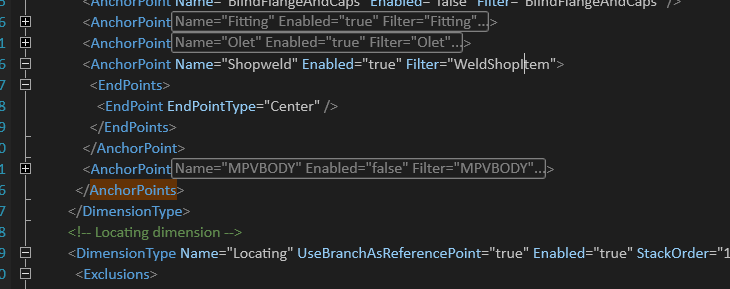

i have done this.
Message 14 of 17

This looks perfect. It should work now.
If it works, please, accept this as a solution.

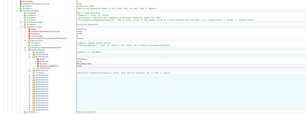

Dear all,
I have same problem. I want to add field for pipe cut length =6000mm.
I already set follow above comment, but Isometric drawing still exist.
Please see attachment pictures.
