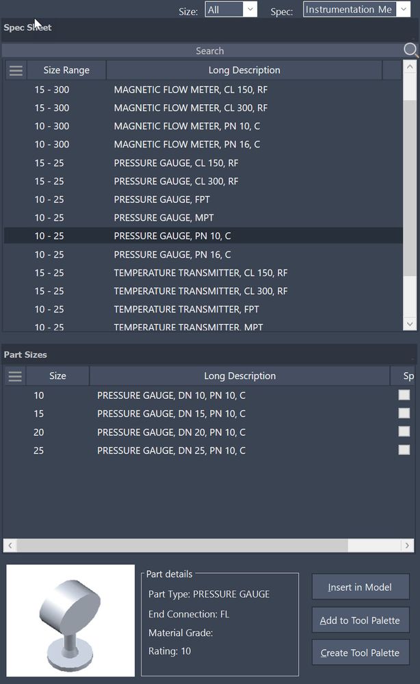

fahmi_audishNMWLM
The thing is, I see "instrumentation Metric" in the Pipe specs (pic 1), but I can't select it in the box for "Route Pipe" (pic 2)

h_eger
If you open your Instrumentation Metric Spec from your P3D project for editing in the Speceditor, is your new component also available?

Message 6 of 14
fahmi_audishNMWLM
Yes,

h_eger
Can you check whether you can see your component in the Spec Viewer?
If my reply was helpful, please give a "Kudo" or click the "Accept as Solution" button below (or both).

Message 8 of 14
fahmi_audishNMWLM
No, I can not see my component in the Spec Viewer
Message 9 of 14
h_eger
Then the component is not in your P3D Project Instrumentation Metric Spec.
As already written at the beginning!
