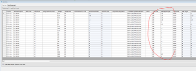

To modify the values, you must export the full catalog to Excel and edit it there:
After making your changes, import the Excel values.

@h_eger is correct that they cannot be added (or seen) per size in the catalog editor GUI. The workaround I detail does provide a way to get custom properties per size in the catalog, specs, project, and report and is not a difficult process.
