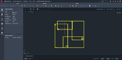

Using AutoCAD Web App to view DWG from mobile is useless if object enablers (in this case Civil 3D) are not supported.
See sample Screenshot. Is there a way to get the Proxy objects shown as well?

I second this idea as well it would be nice (...actually quiet important) that AutoCAD web would include Objects Enablers (all the existing OE).
@Udo_Huebner  There is an half way workaround that you can use for now, better than nothing...
Have your Civil 3D team set PROXYGRAPHICS to 1 before they save their drawings. This way, when you open the C3D drawings using AutoCAD web, at least you can see a representation of the "C3D objects". you will see surfaces and other C3D stuff..., not just "boxes"
Hope this helps.
