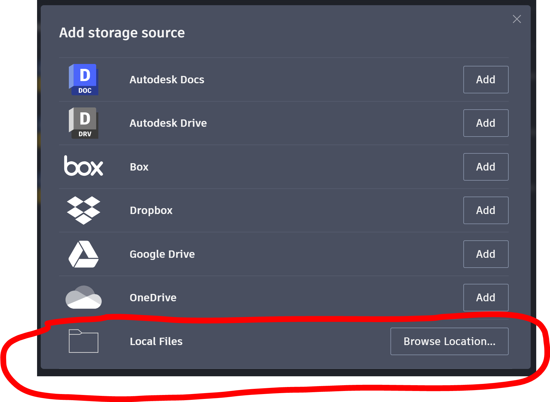

AutoCAD web is a browser-based application. You can get access to web through a stand-alone subscription or if you have access to ACAD desktop it's included as part of your subscription.
We recently released a feature that enables customers to access their locally stored files while using ACAD web in a browser.

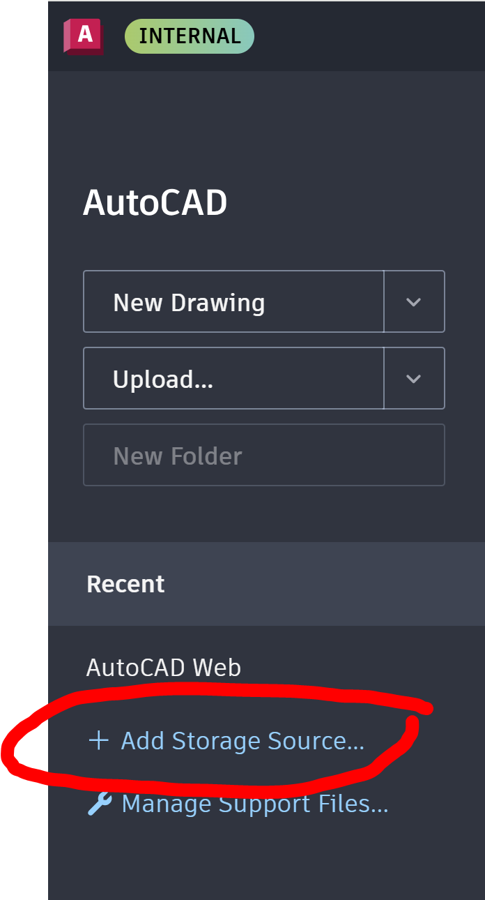

What is Local File Access? Local file access on ACAD web streamlines access to your DWG files saved on a local drive or Local Area Network (LAN), allowing you to make edits directly without worrying about duplicating files in the cloud. See screenshot below for more details.
Don't want to upload a file in order to view it in web? Now you can add a local location (folder) in web to access your files
Browse to select a locally stored folder you want to interact with in web. Once selected you'll see the folder available in web, nothing gets moved, you're simply enabling web to communicate with that folder
Once you add a local location, click on the drawing to open and edit as usual. Any changes you make will automatically save back to your local location. No more downloading a copy.

Doesn't work for me...

As I stated I cannot add a local location. The software provides NO option to do so.

Apologies, as this is an older thread, I was trying to clarify exactly what was not working for you.  Have you taken a look at this workflow, or do you not see these options (images below)?
