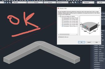

I am veeeery noob to MEP.
I want to draw some ducts but with curved elbows like
the picture below.
Also a dialog appeared to choose from.
Now, I don't know what I do wrong but
every time a create two ducts with an angle,
it creates only rectangular elbows....
How can I stop this and bring back the dialog
to choose from what elbow shape should I use?
Thanks a lot
Petros.
531 Views
jtm2020hyo
try FITTINGREPLACE command.
pproestos
thx yessss 🙂 🙂
It changed the elbow as I want...
thx for your precious help 🙂
