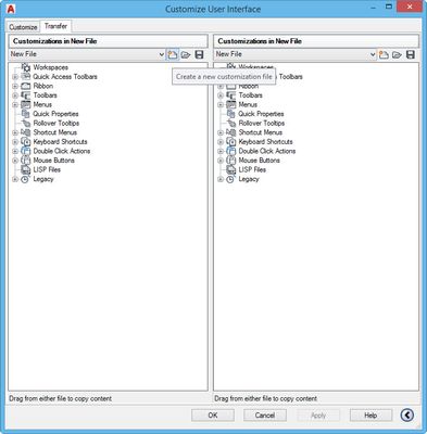

I can see the customization option there in your snap, click that option, a window will open "Customize User Interface".
Go to "Transfer" Tab
Load a previous configuration (*.cuix)
Browse path : C:\Users\folder of your name\AppData\Roaming\Autodesk\AutoCAD 2017\R21.0\enu\Support
do necessary steps if it asked to do by pop-up windows if any.
Now press apply & OK.
Check again and select interface which migrated from previous version. In this current UI, you will see the AutoCAD tools.
