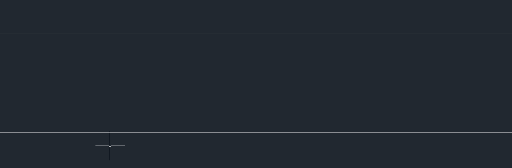

However, if I zoom in on the meeting point, as in attachment 'Zoom', these objects actually have a very small z-separation. This Z-Separation crashes some of the processing I do. Physically I expect these objects to be stacked on top of each-other with no air gap.

Your question might be more complex, but here is a quick way to make sure that all the AutoCAD (Mechanical) solids lay on the plane at Z=0
Have a look at the following screencast:
Move to the Z=0

This solution looks like it is exactly what I need, however the geometry tab is missing in my properties palette. I followed the guidance given in:
 https://knowledge.autodesk.com/support/autocad/troubleshooting/caas/sfdcarticles/sfdcarticles/proper...
however the geometry tab is still missing. Any further suggestions greatly appreciated.
EDIT: Have also tried re-installing AUTOCAD & AUTOCAD Mechanical. The view tab ls present when nothing is selected but I only get General, 3D Visualisation and Solid history as my tables

On your follow up question, the 3 sections you noted are correct when nothing is selected. Once an item is selected, relevant specialized sections are added. For the Geometry section to show, an object (usually linework) does need to be selected.
