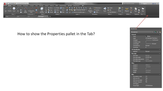

I there any option to show the properties pallet in the toolbar as shown in the attached screen shot, so that we can avoid typing the command PR every time and this was there in AutoCAD Mechanical 2014 but i am not able to find in AutoCAD Mechanical 2017.

Hi @basmalli,
That is a great question. The Properties Palette is an entity separate from the Ribbon, but it can be opened from the Ribbon under:
  1. The View tab, Palettes panel.
  2. From the pop out arrow on the Home tab, Properties.
See the screen shots below.
Properties in the Ribbon.JPGT
Please let me know if this answers your question or if you have further questions.

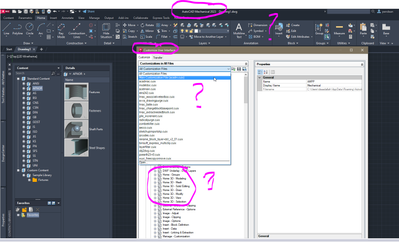

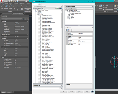

I get to the part of being able to add in  a panel to the Home tab via the CUI however I can't find the Home-Properties panel within the list. I'm requiring the Properties Panel within the Home tab as it allows for changing the Linetype easily.
See a screenshot of part of the list below.
Message 10 of 12
pendean
Community Legend
Community Legend
If the panel is in the Ribbon and you can see/use it, then it is in the CUI too, so you either have the incorrect CUI selected before going into the panels section OR you decided not not scroll up/down that area you provided a screenshot for to look for it since it may not be perfectly in alphabetical order all the time for anyone anywhere, CUIx placement tends to be by edit
Message 11 of 12
mrshayboo
By "incorrect CUI " are you referring to the different workspaces? neither have the Home- Properties panel.
The issue is that I can't see that specific panel. I have looked through the whole list (see pic attached if you don't believe) and it doesn't contain that panel.
My AutoCAD Elec does contain that panel, Is there a way I can transfer that over?
I've tried copying the workspace from ACADE CUI and pasting it in ACADMECH CUI but that doesn't work.
Message 12 of 12
pendean
Community Legend
Community Legend
@mrshaybooIn your screenshot, you are running your older than 2023 ACADE "as AutoCAD".
The "correct CUI" for that panel you want would be this one (ACAD.CUIx)
When running ACADE as ELECTRICAL, the ACADE.CUIx does not contain the plain-AutoCAD panels, you have to select the ACAD.CUIx from the list first then you see the panel you want
MECHANICAL seems to not autoload ACAD.CUIx when run as MECH, at least not in my 2023
