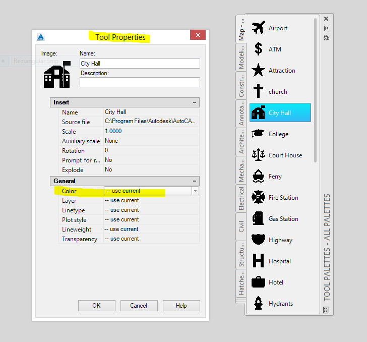

Ok, so tool pallettes had all this stuff I didn't want so I never used them. Now I have my own blocks and hatch patterns on there. What a relief 🙂
But I can't insert them properly. Well the hatch patterns are good but the block I am inserting is teensy, even though I am using the same units and it gets inserted to some random layer instead of the layer I am working on. Why would that happen?
Message 11 of 16
And even though the properties are set to 'By Layer' the colours are wrong 😞
Message 12 of 16
Murph_Map
Are you setting the properties in the palette or in the dwg the blocks are in?
Murph
Supporting the troops daily.
Message 13 of 16
Ah, thanks! And there is an option for prompt to rotate, fantastic.

On a somewhat side note:
I noticed that in your screen shot, on your tool pallette, there is a tab for map symbols.  Is that something you custom made, or is that part of the Map software?  Just curious, as i have Map 2015, and i don't have that tab on my tool pallettes and now wondering if it wasn't installed correctly.
thanks!
Lorrie
Message 16 of 16
Murph_Map
That tab is one I created from the Design Center. If you open up design center "DC" then navigate to the C :\Program Files\Autodesk\AutoCAD 2015\Map\Sample\Symbols dwg you can create a tool palette from that dwg with all the blocks. Or any of the blocks in the dwgs in the sample folders or your own dwgs.
