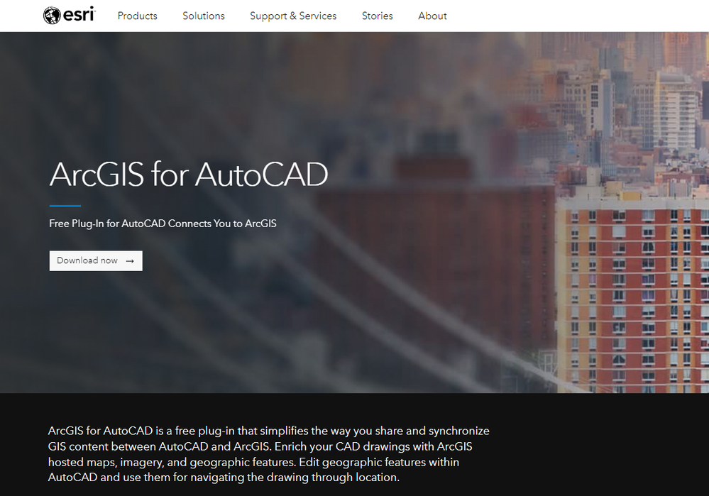

Hello @paulhrussell
Have you considered installing the >>ArcGIS for AutoCAD Plug-In?<< See image-1.
Image-1Image-1
Although you can successfully make a connection to King Co. WMS (refer to post 9 of this thread), you can't connect to King Co's other service, their WMTS server, using Map3D's Data Connect Palette. The plug-in is another way to make the connection. After install, you'll have an ArcGIS tab with buttons for Contents and Add Data/Add Data by URL. See image-2.
