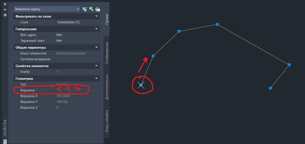

Hi all,
Why in the last versions of AutoCAD Map 3D when you select a map element in the connected SHP file, you can't switch through the vertices in the properties field and view their coordinates?
Thanks in advance.
Eduard Karadzhaian

АлексЮстасу
Now I look in 2012 and in 2018 - there is also no opportunity.
Поле "Вершина" в Свойства есть, а возможности не было и в указанных версиях.

@АлексЮстасу our customer sent me the screenshot where it is possible in AutoCAD Map 3D 2020, so I wanna know how I can get this result. Also customer wants to make this result permanently.

Exactly! You're right!
I looked now in 2019 - the ability to view vertexes in this version is active.

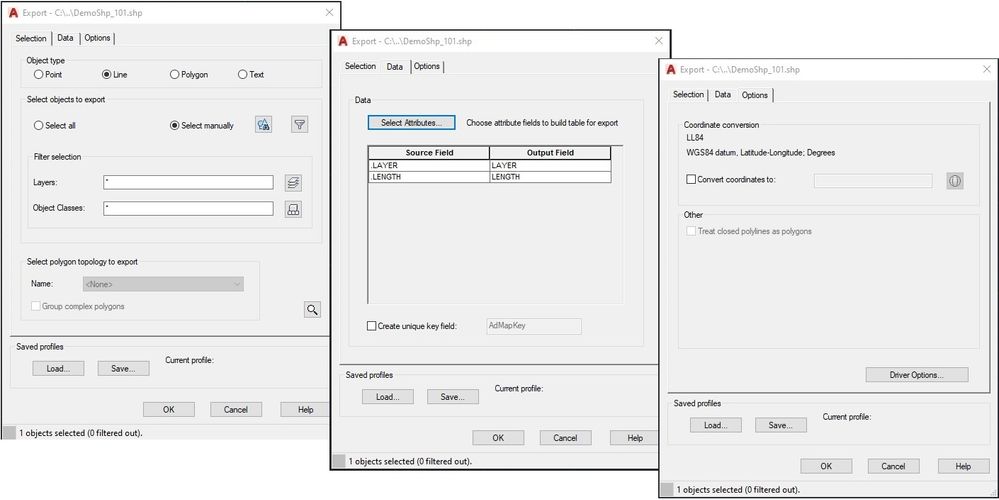

ChicagoLooper
Did you make that shapefile using MAPEXPORT command? If you did, can you recreate the shapefile. During the creation procedure, can you take a screenshot of each tab in MapExport procedure. When you uploadyour screenshots, it can look like this:
