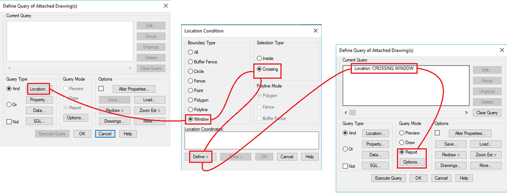

You can do it with a query. To print the NAMES of the drawings use a Window to define your desired area and create a Report.
Open a blank drawing. Assign the appropriate coordinate system. Attach (drag-and-drop) all the drawings onto Map Explorer Tab of the Map Task Pane. If feasible, use your judgement and only attach the drawings in the vicinity of your desired area.
Perform a query. For Location define your area using a Window. (Instead of a Window, you may also use the polyline or polygon option.) See Image-1.
Image-1.Image-1.
To retrieve the name of the drawing(s) in your desired area use the Expression 'DWGNAME' under the Properties Section. Use the Browse Button to name and save the  REPORT. The Report will use txt fomat and  indicate the names of the drawings in your desired area. See Image-2.
Image-2.Image-2.
