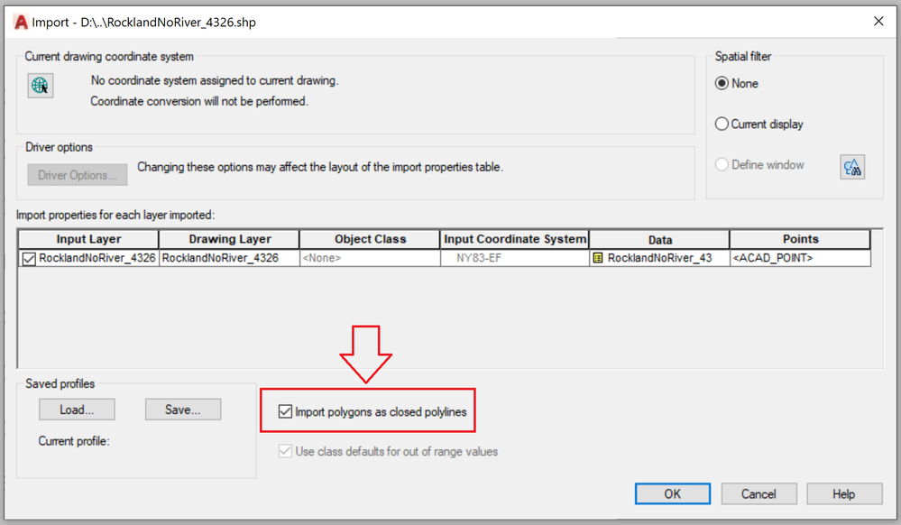

I use map 3d with shapefiles to create location plans, but the final drawings need to be modifiable by users who do not have a map 3d license. In standard AutoCAD, map 3d polygon features are "map features" that cannot be edited.
So, I have to use the "Save as AutoCAD Drawing" feature (Task Pane >> Display Manager >> Maps).  This results in map 3d polygons becoming a combination of polylines (the polygon boundaries)  and hatch objects (the polygon fill).
Only the polylines are needed, the hatch objects serve no purpose (and in some cases there thousands of them) so I was hoping there was a way to prevent them from being created in the first place.
I've tried setting the symbol style in map to be a non-filled polygon, but this makes no difference.

Pointdump
Sean,
"Only the polylines are needed..."
How about using MAPIMPORT?
